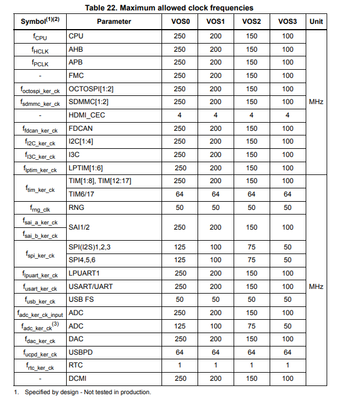

In fact the same table is provided for STM32H5 product in the datasheet:
Thank you.
