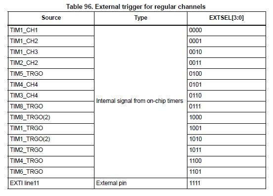

Don't know what part you're using.
The input capture does CCR2 = CNT, it wouldn't really matter what CNT was doing, which presumably be a maximal setting, as you would just be using it as a trigger event. The ADC would explicitly have support for TIMx_CHx, or be mapped at the TIM to be TIMx_TRGO
The Reference Manual for the part should have a list of trigger sources.

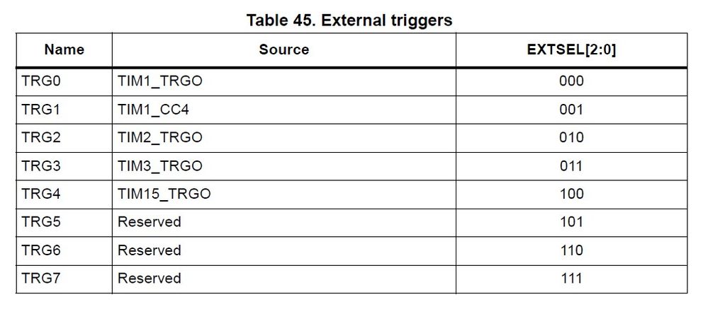

I'm using STM32F051 - this is the ADC trigger
Can use TIMx_CH1 for timer clock and also for input capture?
