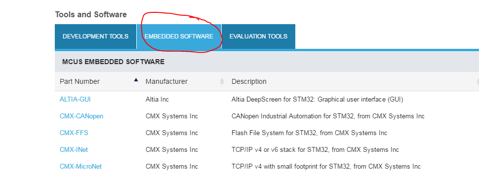

,The
AN4667 application note is part of
software expansion for STM32Cube, so you find it under
Tools and Software > EMBEDDED SOFTWAREof
F7xx pages:
-Nesrine-
2017-05-15 4:45 AM
Nesrine,
Yes I saw that. But that appnote contains general information pertaining to the 'F7 more than to Cube/MX, and there's a lack of such information in the appnotes offered in those places. I am not interested in Cube/MX and I am not the only one.
So, let me rephrase: please provide this or similar appnote in the basic 'F7 resources.
Thanks,
Jan
