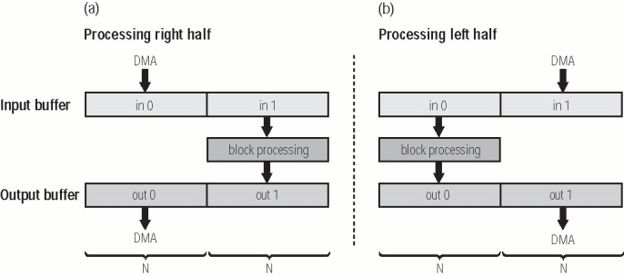

I'm making some clarifications. Namely, I use a circular DMA with a double buffer to read a sound.
The Wave file is stored on a USB stick and is loaded by a routine using the BSP_AUDIO_IN function.
The double buffer is BufferCtl.buff with a size AUDIO_OUT_BUFFER_SIZE
The buffer is only half used with each BSP_AUDIO_OUT_TransferComplete_CallBack and BSP_AUDIO_OUT_HalfTransfer_CallBack call.
BufferCtl.buff
[0 ---- > AUDIO_OUT_BUFFER_SIZE/2]
BufferCtl.buff
[AUDIO_OUT_BUFFER_SIZE/2 ---- > AUDIO_OUT_BUFFER_SIZE]
