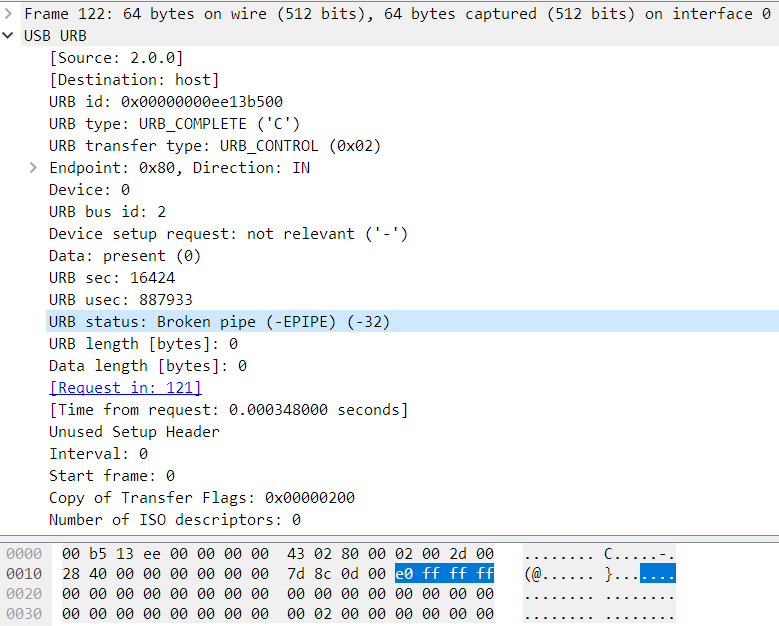

We have the STM32F777VI in HS USB mode using external ULPI. We are using the CDC virtual com port (VCP) example with V1.2.5 HAL Driver and V2.4.2 USB Device Library. Without DMA everything works fine. But as soon as DMA is enabled (hpcd.Init.dma_enable = 1) the USB enumeration will fail at the very first response (device descriptor request). Wireshark and usbmon on the linux host will show that the descriptor response status from the STM32F7 is -EPIPE
