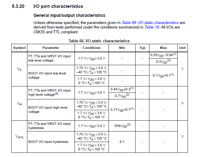

I am using STM32F777, can you please help where i will get VIH voltage level for SPI Ports in datasheet?
Please help
2022-10-29 6:14 AM
see in ds :
I/O port characteristics -> General input/output characteristics -> Vih
2022-10-29 6:26 AM
Hi AScha,
Thank You.
For better understanding, I have attached Snapshot form STM32F777 Datasheet.
Also please confirm it is applicable for SPI Channel as well.
In my Case, I have VDD:3.3V
So VIH=(0.45*VDD+0.3)/(0.7*VDD)=(0.45*3.3+0.3)/(0.7*3.3)=0.77V
is it right? Please confirm

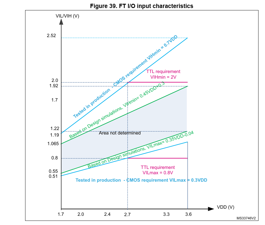

2022-10-29 7:05 AM
nooo....no division !
tested is : 0,7 * Vdd -> 2,31 V min.
here you see : tested 2,3V ; may switch from 1,7V up (green line).
and SPI is same other port pins , ok?
