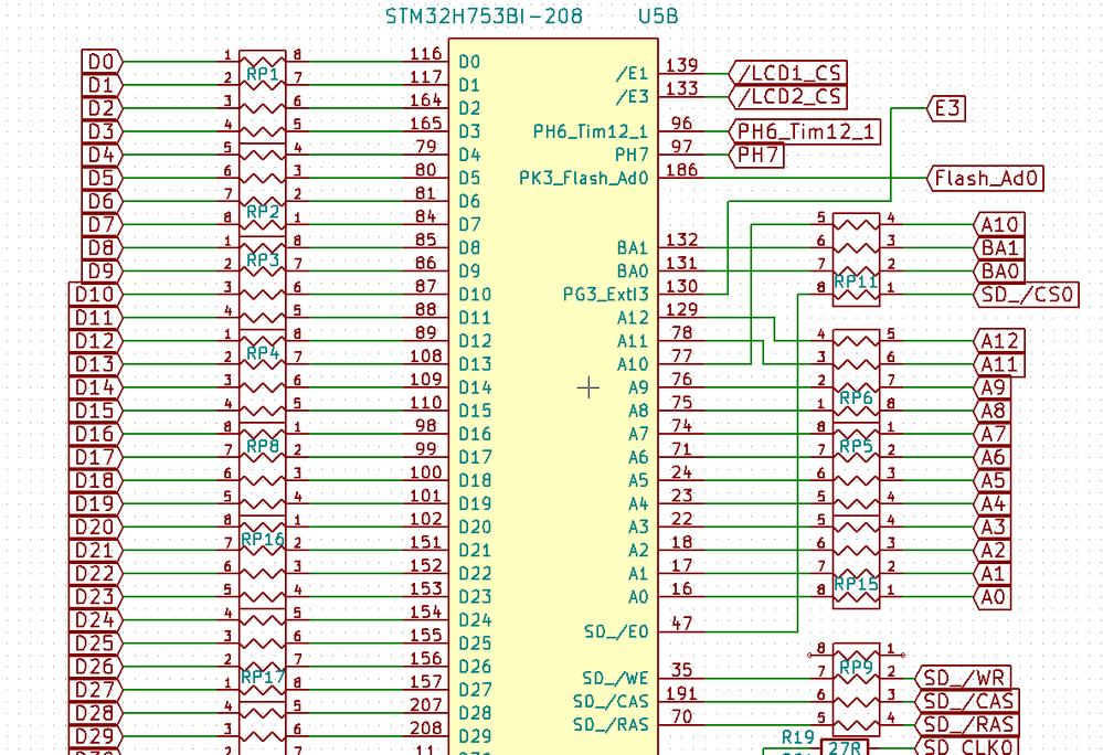

2018-06-26 6:12 PM
Of course its going to get hot.
with LCD and SDRAM, you are pounding the bus matrices.
is it your custom board ?
easy fix use a heatsink, biggest possible within the package
The proper fix is inline resistors on every high frequency line:
data/address lines and Qspi lines ( nSS not needed)
LCD too maybe... definately the LCD clock pin
I use 27R or 33R, upto 100R should be ok.
These are 4x33R packs. like this one
https://www.digikey.com/product-detail/en/rohm-semiconductor/MNR04MRAPJ300/RHM1349TR-ND/4083230
The advice is to place the resistor as far away from the processor as possible.
