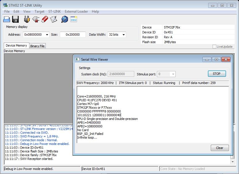

I also just tried the 'STM32 ST-Link Utility' with SWO viewer and can see a few characters when I press start but do not see a continuous stream of characters as i expect.

@Chris Lynch, do the characters you see resemble what you print?
-- pa
Posted on March 06, 2018 at 09:31
Pavel,
           Thanks for asking.
            Yes they did, but i only received about 4 characters when i should have received a character every 100ms.
           See my answer above regarding the ST-Link firmware as the actual problem.
