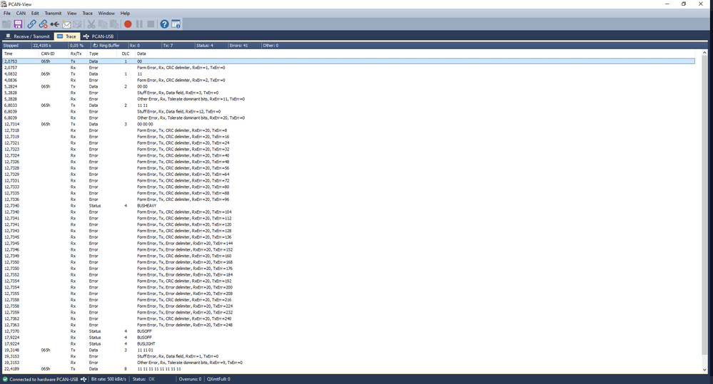

i am currently trying to get the can bus on my Nucleo-F767ZI running.
Now i got a problem that every time i sent a message via CAN (from my PCANView) which is longer than two bytes i got a Bus-Off error, but if byte 2 is not empty i can sent messages with more bytes. Maybe someone here can explain to me what i am doing wrong. If you need everything else for helping me, i will upload the requested files.
Thank you for your time and help.

This is a screenshot from the Trace Window of the PCANView:
