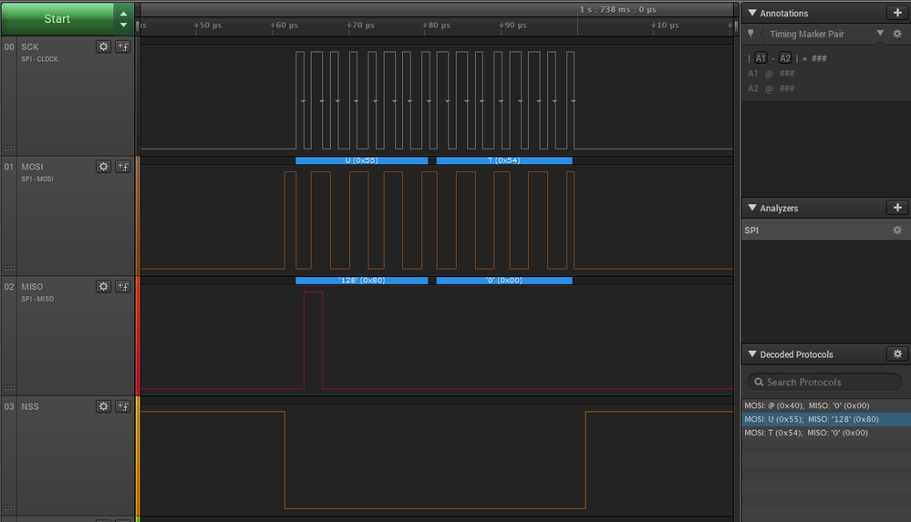

I started now programming the STM32F767ZI MCU and do not have any experience with 32bit uController.
I have to programm a project, which includes a SPI communication to an external ADC. It must be programmed with the LL library and I'd like to do this by DMA.

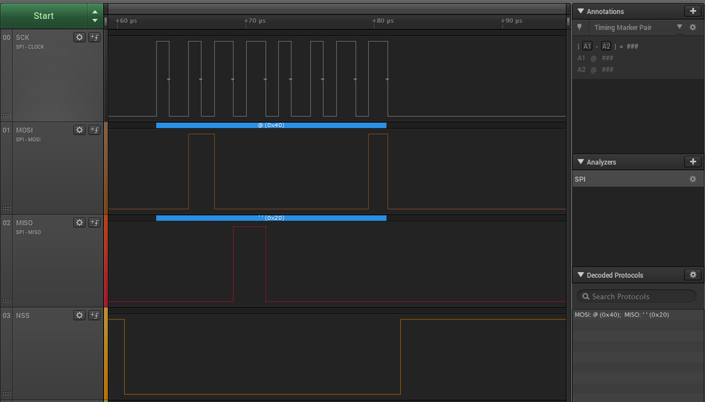

My problem is, that my programm sends out only one byte at the first frame although it is four bytes long (I checked the datalength register: 4 bytes). Additionally the last bit will not be send correctly, because the clock falls at the same time the MOSI signal falls to zero (see attachment).
The two graph shows the signals after sending two frames ('0x41' , '0x55', '0x55'). The second frame starts after the ready interrupt of the DMA.
I think, that both problems causes in the initialization:

2020-06-13 5:58 AM
DMA initialization seems fine. How are you starting/stopping the transfer? I wouldn't recommend using the FIFO unless you are only sending data which is a multiple of the FIFO length you're using.

2020-06-13 6:55 AM
Well, a few things:
Since you have CPHA=1, there is no delay between when the last bit is sent (falling edge) and when the transmission completes. If you want a delay there, you'll need to add it.
I don't ever see you calling LL_SPI_EnableDMAReq_TX or LL_SPI_EnableDMAReq_RX, but since it's working, presumably you are doing this somewhere.
It looks like you can send a frame of 1 byte and 2 bytes. I see no reason why a frame of 4 bytes wouldn't work based on the code you showed.
