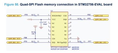

Hi there, i come across AN4760 p55, configuring GPIOB with alternate functions :
GPIOB->AFR[0] = 0x0A000900; where does this 0A000900 come to config PB2 n PB6 to QSPI alternate function?
GPIOB->AFR[1] = 0x00000000;
GPIOF->AFR[0] |= 0x9900000000; how this 9900000000 set to config PF6, PF7 PF8 PF9 to QSPI alt. function?
GPIOF->AFR[1] |= 0x000000AA
Pls advise...thx.

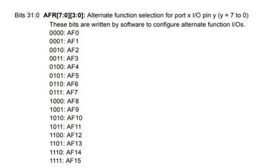

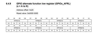

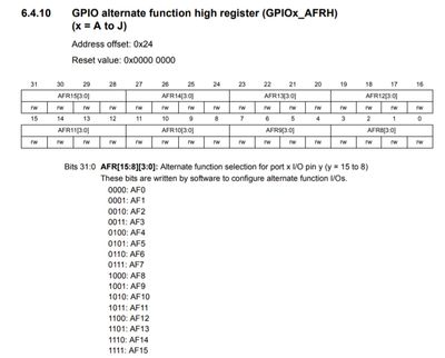

Hello @StanJerm ,
When you refer to RM0385 as already mentioned by @Issamos , the configuration of alternative function of PB2, PB6, PF6, PF7, PF7 and PF8 are made in GPIOx_AFRL (GPIOx->AFR[0]) and in GPIOx_AFRH (GPIOx->AFR[1]).
In this case:
-GPIOB configuration is done by:

2023-09-07 9:09 AM - edited 2023-09-07 9:13 AM
Hello @StanJerm
The board and the quad-spi flash memory are connected like this:
Then we have to programme every pin to the alternate function that it should be using. Taking a look to the DocID027589 Rev 4 (datasheet of the STM32F756) we find out that PB2, PF6 and PF7 should be configured to AF9 and PB6, PF8 and PF9 should be configured to AF10. Then and using the GPIO alternate function low register (GPIOx_AFRL) and GPIO alternate function high register (GPIOx_AFRH) we have to do this configuration. Wish is the same as the Alternate function configuration in the AN4760. ( have a look at RM0385)
