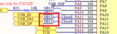

HELLO guys could you please tell me how to put the stm32f746zg board in dfu mode actually earlier i was able to program and use the stlink to dump but currenty im not able to connect using stlink so i want to do with the dfu stm32 bootloader mode i have refered the manuals but cant find the solution please help me in this .

You need also to ensure that the solder bridges SB132 and SB133 are present:
And connect the USB cable on CN13 not to the STLINK USB port.
How to proceed:
1- Boot pin needs to be pulled up (connected to VDD).
2- Reset the MCU
3 - Select "USB" mode in STM32CubeProgrammer interface:
4 - Click connect button:
You should be normally connected in DFU mode.
Hope that helps.

The Micro USB at the South End of the board connects to the F746 directly. I would try that with BOOT0 jumpered to VDD to check DFU method of connectivity.
