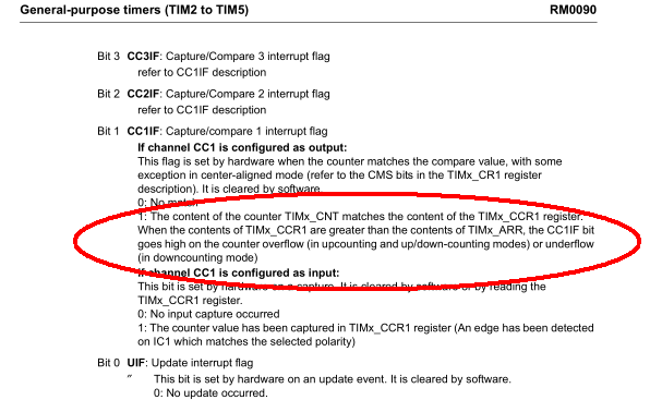

> .Pulse to 5000 from 50, the ISR is still entered. I was expecting that only when the Pulse
> Value (CCR1 in this case) matched with the Counter Value (TIM1->CNT) the Compare
> Interrupt would be triggered
No, this is an exception (and yes it's surprising to the unaware):
The CNT register content appears to be random as your interrupt service routine (ISR) executes waaaaay longer than the time between consecutive interrupts is.
Bottom line: NEVER use printf() and kin in an ISR.

2019-02-10 9:52 PM
The timer over flows and runs continuously.
This code that I have presented here was simplified to reproduce the problem. The original code has the required instructions to clear the interrupt flags. Still the problem repeats.
2019-02-10 10:01 PM
Thank you jan for passing the reference.
Probably a bad choice, but I used the printf as a sample instruction to hold as a breakpoint and to observe the value of the variable through the Debugger . This was a simplified code I wrote out to demonstrate the problem. Didnt want to clutter the post with all the unnecessary details from the original code.
Once again Thank You Very Much for pointing out the issue.
