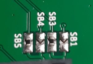

How do you set the relevant solder bridges (SB1, SB3, SB4, SB5)?

The SB pin should be in the default configuration
