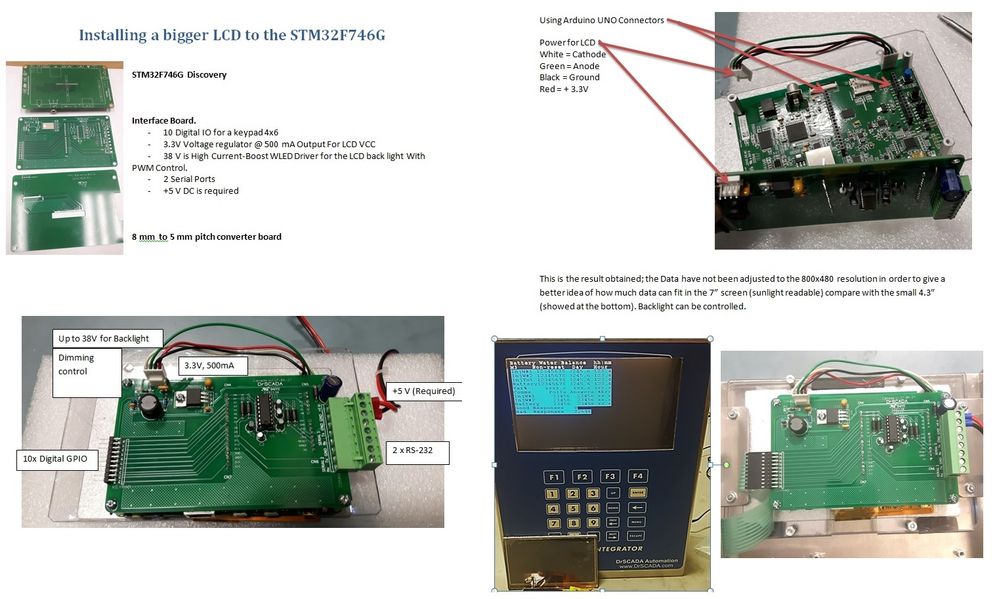

This is How we solved the issue of having a small 4.3'' and also non sunlight readable LCD.
