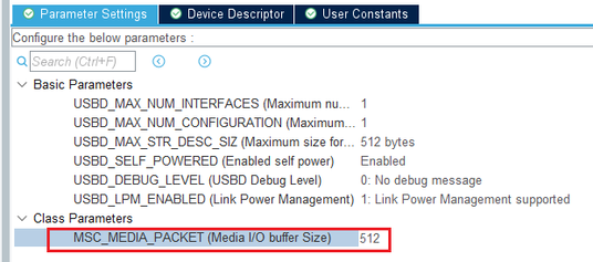

I enabled ICache and DCache, Heap Size= 0x2000, Stack Size= 2000, MSC_MEDIA_PACKET= 512.

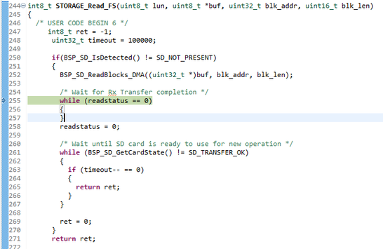

While debugging, I noticed that there were no interrupts, and the program was hanging in a loop, as shown in the picture below.
Then I commented out the while loop and the interrupts started working. I was able to read and write data to the uSD Card. I can't understand the reason for this behavior of the program. Please tell me what am I doing wrong?

Code is far from ideal
Needs better timeout and bounding conditions.
The second loop needs to be bounded by TIME, not ITERATIONs
Likely seeing cascading failure, where the prior command didn't complete properly, so the next doesn't start nor interrupt.
The coherency issues on the F7 can be entirely avoided if the DMA buffers live in DTCM-RAM, the code doesn't need to be there.
I'd bound the first loop by TIME to, and fail with an error, not just stop and die there.. Removing it solves no problems.

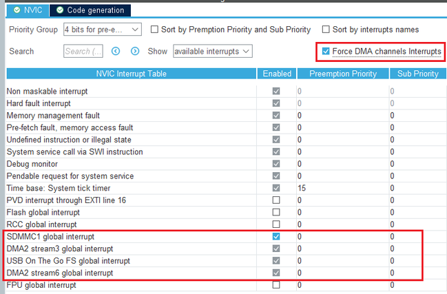

I have completed all the settings in CubeMX. The table below shows the interrupt priorities.
Please tell me how to correctly set interrupt priorities?
