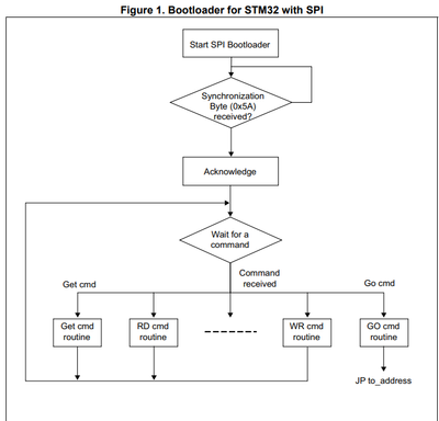

I invite you to refer to the application note AN4286 "SPI protocol used in the STM32 bootloader"
Do you think this is what an SDcard over SPI is expecting?
With SPI bootloaader STM32 behaves as a slave to a SPI Host while with a custom bootlader STM32 is a host and the SDcard is a slave over SPI. Moreover, the bootlader protocol over SPI is not compatible with the SDcard protocol communication over SPI.

2025-03-30 1:29 PM - edited 2025-03-30 1:54 PM
