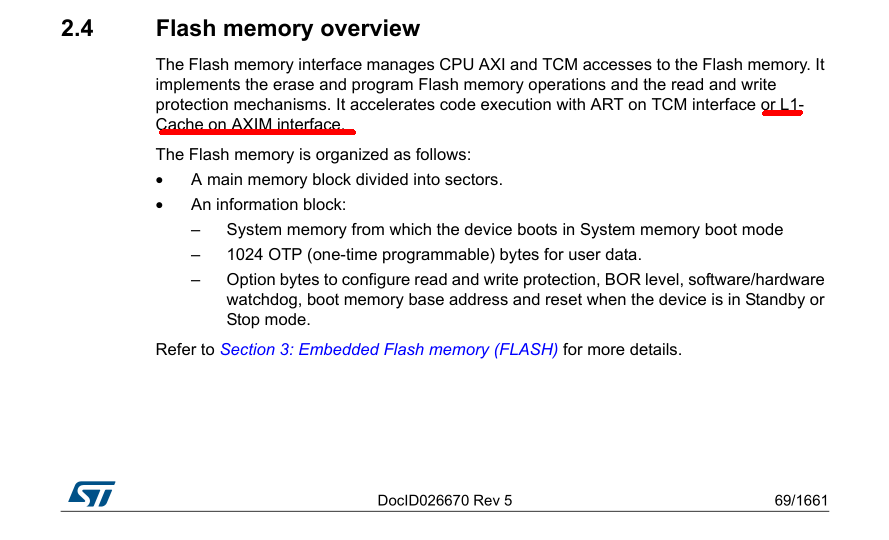

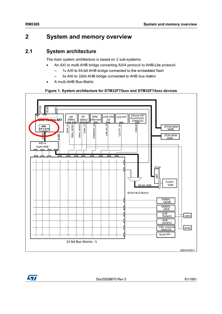

The only explanation for this behavior that I can think of is the relative positions of these two tasks in memory affects how the code is cached by the CPU. This is where I'm puzzled, however. According to the datasheet, only FLASH on the ITCM interface uses the ART accelerator. My code is in the FLASH on the AXIM interface.
Is there another instruction cache different from the ART accelerator? Is there any way to disable it to check whether it's the cause of the effect I'm seeing? I didn't find anything in either the datasheet or the reference manual.

Read AN4839 and AN4838.
2017-07-09 4:39 PM
Interesting. Thank you. I missed that in my reading of the manual.
I read those two app notes and better understand the relationship between the L1 cache and FLASH.
Now I'm seeing behavior that's even more puzzling. There are two bits in the CCR (Configuration and Control Register) on a Cortex-M7, CCR.IC and CCR.DC, that control the enabling of the instruction and data caches. I my case, both of these bits were set to zero when I ran my test yesterday. So with the instruction cache off, two identical tasks would run at different speeds depending where they were placed in memory (FLASH). With certain placements, one task ran about twice as fast as the other.
I ran the test again this afternoon, and confirmed that one task runs about twice as fast as the other with CCR.IC cleared. The really puzzling thing is when I set CCR.IC to '1' to enable the instruction cache, both tasks run at exactly the same speed! I'm at a loss to explain this. My previous assumption was that one task ran faster than the other because it was preferentially cached in the instruction cache. Now I find that I had the instruction cache turned off yesterday, but now when I turn it on the issue goes away.

What is the relationship between the CCR.IC bit and the memory protection unit (MPU) on an STM32F7? The ARM documentation says 'It is IMPLEMENTATION DEFINED whether the CCR.DC and CCR.IC bits affect the memory attributes generated by an enabled MPU.'
AN4839 says that when the MPU is disabled (which it is in my case), a default memory map is used, and according to the ap note, the code region's cache policy is write-through. Does that mean that the instruction cache is on irregardless of the state of CCR.IC?
