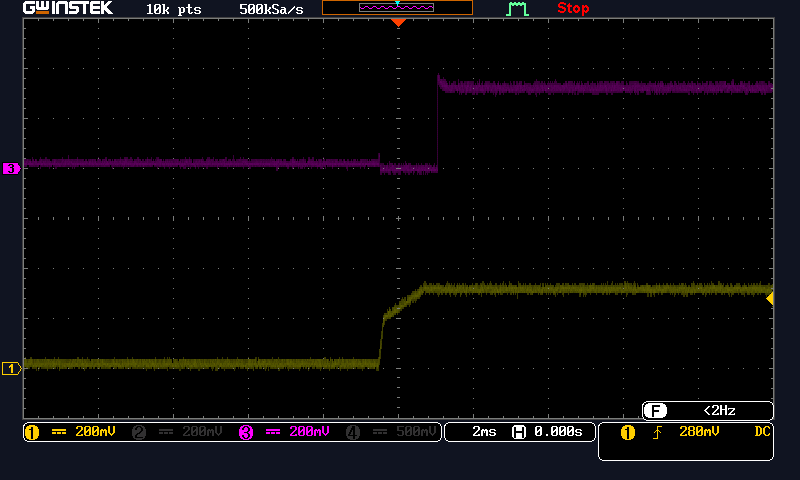

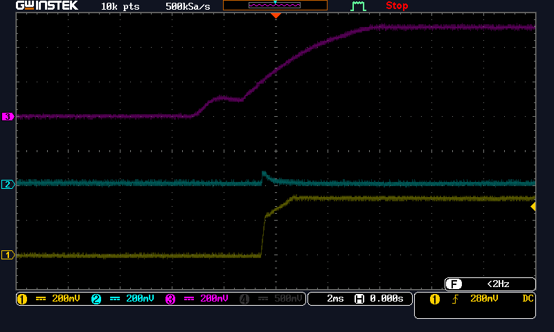

The first idea was that there is a power issue, but I set the Brown Out Reset level in the option bytes to around 3V. Looking at Vin (3) and Vout (1) of the regulator, voltage seems to be fine. (2) is the output of a GPIO output which was initialized to HIGH in MX_GPIO_Init() -- but it remains LOW, which means the program is not executed.
The duration until the voltage has risen to 3.3V is more than 1ms, but according to the datasheet the rise time doesn't matter (if it's not too short).
Looking at the NRST pin (with only a 10K pullup attached, but no flasher device), this is curve (3) while (1) is Vout, i.e., Vdd of the STM32.
The increased BOD level seems to work; the STM32 starts working after the voltage is stable.
Thus, the voltage doesn't seem to play a role in the STM32 not starting up. What else could prevent a startup?

As said, I'm using HSI and LSI, and that is what's configured in CubeMX.
I don't have a capacitor for NRST (I missed it), but then should its effect not be similar to raising the BOD level? If you look at the last graph, you see that NRST goes HIGH well after the voltage is stable. If I'm not mistaken, that's the entire point of the NRST capacitor (together with the resistor, an RC delay element).
