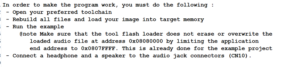

At the bottom of the readme file for the BSP project for this board says:
How do you limit the application end address?

In the linker script, set the FLASH section to be 512kB in length:
/* Memories definition */
MEMORY
FLASH (rx) : ORIGIN = 0x8000000, LENGTH = 512K
