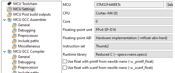

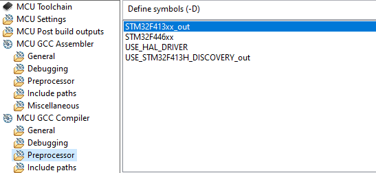

I'm using a STM32F446RE Discovery board and would like to test the SBSFU on it. At them moment, I take the example code from the STM32F413H Discovery board, but I'm not sure what I'm doing wrong to never get access over the tera terminal.
What I have done so far according to AN5056 is:

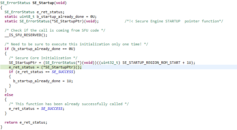

The thing is, I am not able to debug (I think this is normal, but I tought with the SECBOOT_DISABLE_SECURITY_IPS flag, I would be able to do that), since the fw directly goes into the hardfault at bootup. Also when I do the 2 power cycles as described in the AN5056, I never get a terminal output.
How can I check, that the SBSFU is correctly installed?
Edit:
Ok, I optimized for debug and can no see where it happens:
Seems to be a problem with the ROM region
2022-01-04 2:44 AM
Hi @STsch.1 ,
apparently SECoreBin initialization fails. When you changed the build settings for debug, maybe the code size increased and you need to revisit the linker settings.
BR,
J
