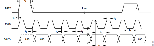

SPI should be set up correctly. CPOL = 0 and CPHA = 1.
This is the timing diagram of the ADC that is sending the data to the MCU (AD7768-4)

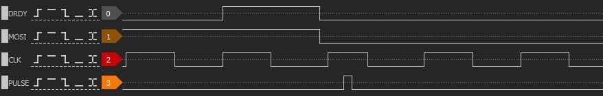

Well here you go. I expect that you now have a solution for my problem.
The PULSE signal is there so that I can visualise when the SPI has been enabled (using SSI) and when the DMA transfer has been completed. The first pulse is sent after the SPI has been enabled so that I don't introduce additional delay.

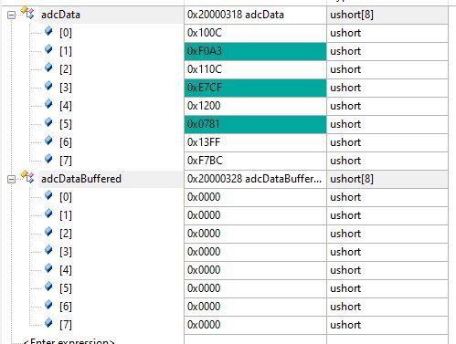

And here are the values:

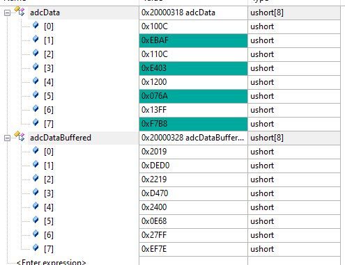

The second buffer is empty as I didn't sent a measure command yet. Indices 0, 2, 4, 6 are the ones holding header data that is constant. And only the 8 MSB are the header data. Everything else is the ADC measurement data. So if I would combine [0] and [1] that would give me 0x100CF0A3 and 0x10 is the header indicating channel (0) and some other status bits and the 0x0C40A3 is the 24 bit measurement data. Same goes for 2,3 and 4,5 and 6,7 (this is a 4 channel ADC).
Once I send the measure command over USB this is the result:
Look only at the header data as everything else is ADC data and is not the same in the pictures as the DMA2 stream0 is running and I can't do 3 printscreens in the same time. You can see that it is shifted for 1 bit.

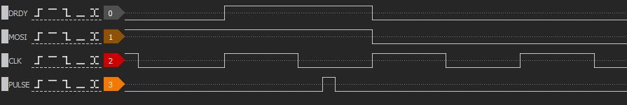

I found out that when I send my trigger over USB that introduces a delay somewhere that causes my EXTI interrupt handler to execute slower (too late). That causes the 1 bit shift. But If I sent every 500th (or 200th, 100th,... doesn't matter matter) measurement automatically there is no such delay.
And how it should be:

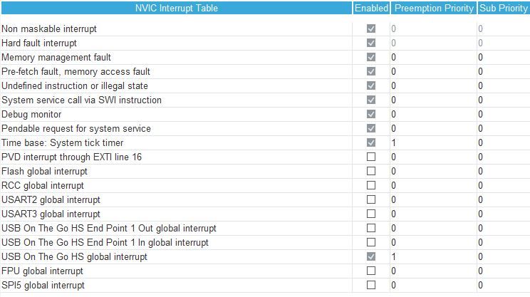

I did set my EXTI1 to highest priority from the program
NVIC_SetPriority(EXTI1_IRQn, 0);And this is how it looks like in cubeMX for other periphery:
I am also using TCM flash interface with ART accelerator and instruction prefetch enabled.

But the problem is not the SPI. If I analyse the data with LA the data is still the same. The problem is the added delay before the EXTI1 interrupt handler executes so the SPI is enabled too late.
Without the delay (without the measure command being sent over USB) it takes about 40 clock cycles (MCU is clocked at 216 MHz) which is perfectly fine and fast enough.
And if I send the measure command over USB that is increased to about 65 clock cycles. So something is preventing the interrupt from being executed.
The SPI is clocked at 4.096 MHz so you can easily calculate the time from the images. And the EXTI is triggered on the rising edge of the DRDY signal.
