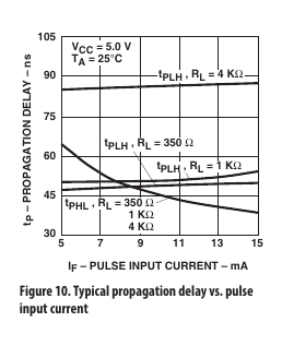

Sorry, 180mA was my estimated max for the entire PCB with a little bit of added margin, but I can crank down the 6 LEDs a bit (they are Optos) before edges become an issue.

Optos don't light up rooms unless you made a serious wiring mistake.
15mA is the upper limit but I probably can crank it down to 10mA without impacting max baud rate...
