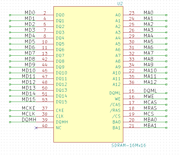

Make sure to do testing with caching disabled
Show schematic for SDRAM, and pin configuration code

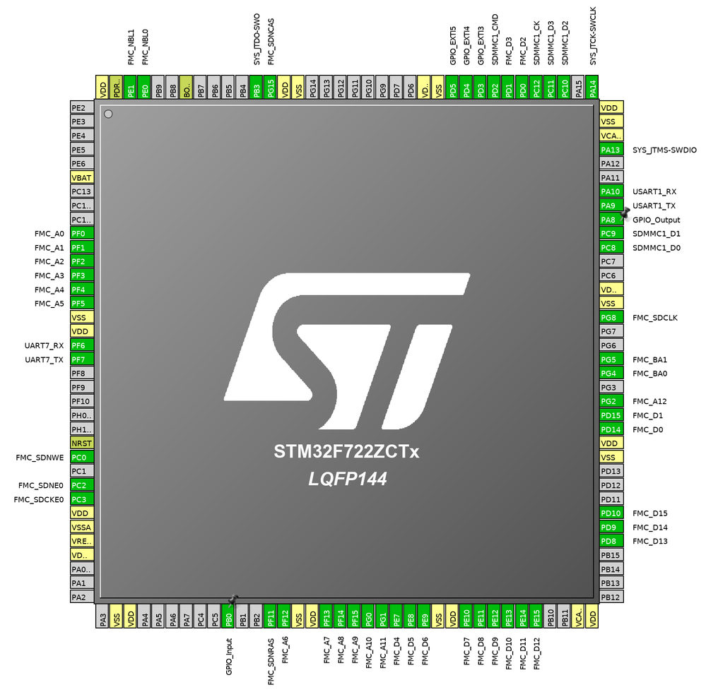

Here's the pin config code:
static void HAL_FMC_MspInit(void){
/* USER CODE BEGIN FMC_MspInit 0 */ /* USER CODE END FMC_MspInit 0 */ GPIO_InitTypeDef GPIO_InitStruct; if (FMC_Initialized) { return; } FMC_Initialized = 1; /* Peripheral clock enable */ __HAL_RCC_FMC_CLK_ENABLE(); /** FMC GPIO Configuration PF0 ------> FMC_A0 PF1 ------> FMC_A1 PF2 ------> FMC_A2 PF3 ------> FMC_A3 PF4 ------> FMC_A4 PF5 ------> FMC_A5 PC0 ------> FMC_SDNWE PC2 ------> FMC_SDNE0 PC3 ------> FMC_SDCKE0 PF11 ------> FMC_SDNRAS PF12 ------> FMC_A6 PF13 ------> FMC_A7 PF14 ------> FMC_A8 PF15 ------> FMC_A9 PG0 ------> FMC_A10 PG1 ------> FMC_A11 PE7 ------> FMC_D4 PE8 ------> FMC_D5 PE9 ------> FMC_D6 PE10 ------> FMC_D7 PE11 ------> FMC_D8 PE12 ------> FMC_D9 PE13 ------> FMC_D10 PE14 ------> FMC_D11 PE15 ------> FMC_D12 PD8 ------> FMC_D13 PD9 ------> FMC_D14 PD10 ------> FMC_D15 PD14 ------> FMC_D0 PD15 ------> FMC_D1 PG2 ------> FMC_A12 PG4 ------> FMC_BA0 PG5 ------> FMC_BA1 PG8 ------> FMC_SDCLK PD0 ------> FMC_D2 PD1 ------> FMC_D3 PG15 ------> FMC_SDNCAS PE0 ------> FMC_NBL0 PE1 ------> FMC_NBL1 */ /* GPIO_InitStruct */ GPIO_InitStruct.Pin = GPIO_PIN_0|GPIO_PIN_1|GPIO_PIN_2|GPIO_PIN_3 |GPIO_PIN_4|GPIO_PIN_5|GPIO_PIN_11|GPIO_PIN_12 |GPIO_PIN_13|GPIO_PIN_14|GPIO_PIN_15; GPIO_InitStruct.Mode = GPIO_MODE_AF_PP; GPIO_InitStruct.Pull = GPIO_NOPULL; GPIO_InitStruct.Speed = GPIO_SPEED_FREQ_VERY_HIGH; GPIO_InitStruct.Alternate = GPIO_AF12_FMC;HAL_GPIO_Init(GPIOF, &GPIO_InitStruct);/* GPIO_InitStruct */ GPIO_InitStruct.Pin = GPIO_PIN_0|GPIO_PIN_2|GPIO_PIN_3; GPIO_InitStruct.Mode = GPIO_MODE_AF_PP; GPIO_InitStruct.Pull = GPIO_NOPULL; GPIO_InitStruct.Speed = GPIO_SPEED_FREQ_VERY_HIGH; GPIO_InitStruct.Alternate = GPIO_AF12_FMC;HAL_GPIO_Init(GPIOC, &GPIO_InitStruct);/* GPIO_InitStruct */ GPIO_InitStruct.Pin = GPIO_PIN_0|GPIO_PIN_1|GPIO_PIN_2|GPIO_PIN_4 |GPIO_PIN_5|GPIO_PIN_8|GPIO_PIN_15; GPIO_InitStruct.Mode = GPIO_MODE_AF_PP; GPIO_InitStruct.Pull = GPIO_NOPULL; GPIO_InitStruct.Speed = GPIO_SPEED_FREQ_VERY_HIGH; GPIO_InitStruct.Alternate = GPIO_AF12_FMC; HAL_GPIO_Init(GPIOG, &GPIO_InitStruct); /* GPIO_InitStruct */ GPIO_InitStruct.Pin = GPIO_PIN_7|GPIO_PIN_8|GPIO_PIN_9|GPIO_PIN_10 |GPIO_PIN_11|GPIO_PIN_12|GPIO_PIN_13|GPIO_PIN_14 |GPIO_PIN_15|GPIO_PIN_0|GPIO_PIN_1; GPIO_InitStruct.Mode = GPIO_MODE_AF_PP; GPIO_InitStruct.Pull = GPIO_NOPULL; GPIO_InitStruct.Speed = GPIO_SPEED_FREQ_VERY_HIGH; GPIO_InitStruct.Alternate = GPIO_AF12_FMC; HAL_GPIO_Init(GPIOE, &GPIO_InitStruct); /* GPIO_InitStruct */ GPIO_InitStruct.Pin = GPIO_PIN_8|GPIO_PIN_9|GPIO_PIN_10|GPIO_PIN_14 |GPIO_PIN_15|GPIO_PIN_0|GPIO_PIN_1; GPIO_InitStruct.Mode = GPIO_MODE_AF_PP; GPIO_InitStruct.Pull = GPIO_NOPULL; GPIO_InitStruct.Speed = GPIO_SPEED_FREQ_VERY_HIGH; GPIO_InitStruct.Alternate = GPIO_AF12_FMC; HAL_GPIO_Init(GPIOD, &GPIO_InitStruct);}2018-07-03 6:12 AM
And here's my CubeMX config. All signals are connected to the obvious counterparts, and the non-obvious ones are SDNE0 -- CS, NBLE1/0 -- DQMH/L.

2018-07-03 6:19 AM
SDRAM schematic (9 column bits, 13 address bits):
