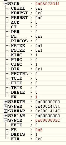

Post the relevant DMA registers' content.
JW2016-07-08 1:27 AM
Ok, here we go:
