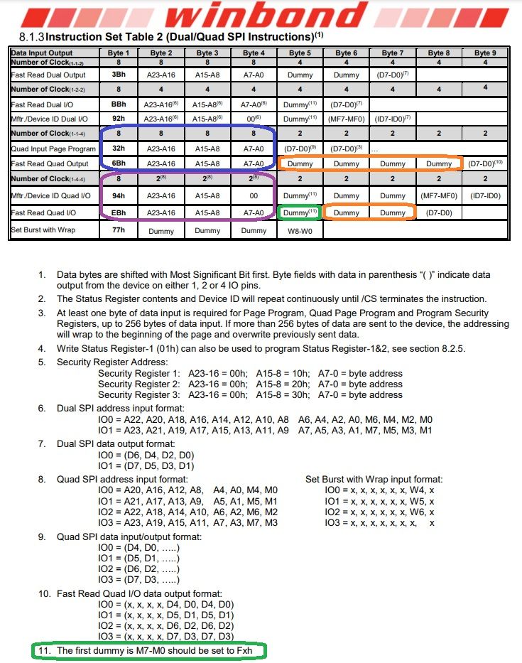

Doesn't 0xEB command expect an 0xF* value in the Alternate byte
Or use try using 0x6B with the ADDRESS in 1-bit, and 8 dummy cycles

I tried changing the byte after the address bytes to the following:
com.AlternateByteMode = QSPI_ALTERNATE_BYTES_4_LINES;
com.AlternateBytes = 0xF1;
com.AlternateBytesSize = QSPI_ALTERNATE_BYTES_8_BITS;
The same result like before.

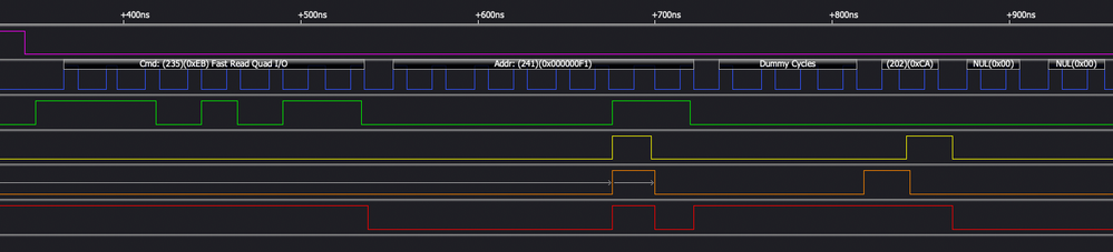

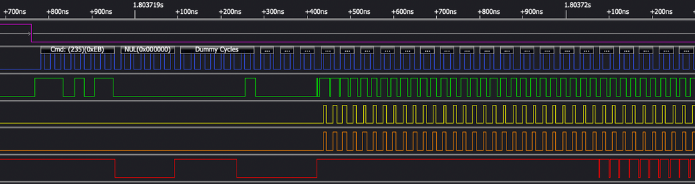

According to the LogicAnalyzer everything looks fine.
Is it normal, that the DQ3 line is high in Idle state?
The analyzer plot is hard to see, looks to be too many dummy cycles.
You really need a good data pattern in the flash, and perhaps show it's response in other modes. Or an MCU side dump of the patterns recovered.

Here is a better picture from the Logic Analyzer output for the Fast Read Quad IO.
