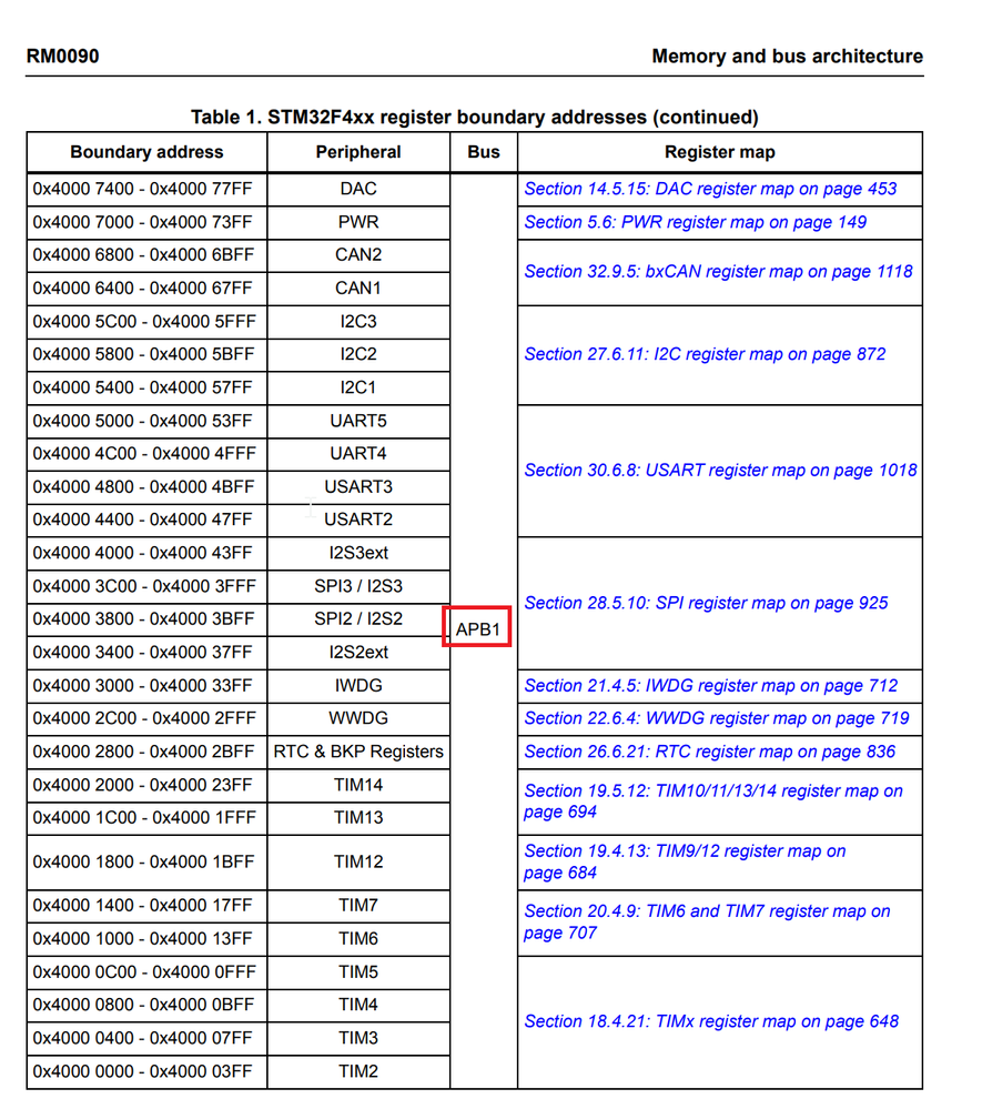

For some time already I cannot find this in manuals. Can someone point me if there is any table somewhere? Of course I can find it out experimentally, but it would be more convenient to know where it is listed.

The mapping is contained in the table Register boundary addresses, usually in section 2 of the Reference Manual. In addition to the border addresses, it also contains the responsible bus.
Good luck!

Thank you very much! For sure I wouldn't find this place myself :)).

2023-06-02 11:57 PM - edited 2023-11-20 9:24 AM
I opened the RM but looked over it, for those not awake in the morning this visual :):
