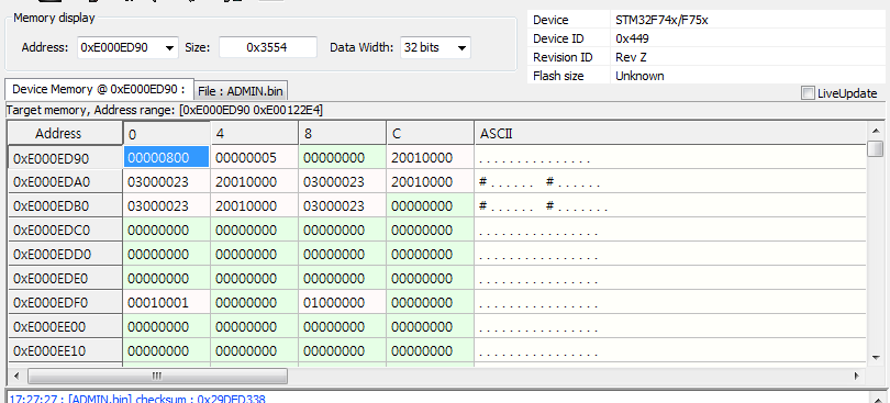

Thank you for answer.
RM0385 Manual was set to see the MPU_RASR register as shown below.Thank you.

The region at 0x60000000 is defined as memory region, so it can use caches and (most important) write buffer. That last can merge and coalesce writes to the memory, this is exactly what happens to you. There are (at least) 2 solutions: 1) declare the region as Device or Strongly ordered, by reprogramming the MPU (don't trust your screen capture, MPU_RASR is a port, and currently related to a 128KB region starting at 0x20010000, according values in both MPU_RBAR and MPU_RASR). 2) use memory barriers instructions between your accesses (DMB/DSB, see the manual to understand difference between them). BTW, if there is memory behing 0x60000000, I will expect that merge or coalescing is not harmfull. What is the use case where writing twice the same memory area is absolutely required ?2016-06-09 5:22 AM

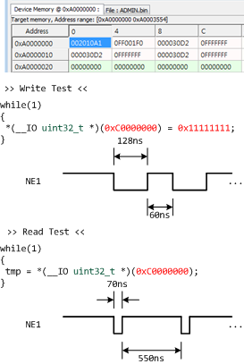

Thanks all,
When you write, as shown below and run the _DSB () function, even if the write to the same address works fine.But the gap between chip select is too large. read also the same.Is there any way to further reduce? Or Is it structurally impossible to?Thank you.
Best regards,gyosun.

Write to the memory swap as follows seems well out the way you want.
But reading is still too big a chip select intervals.Is there any way to further reduce?Thank you.
2016-06-09 11:53 PM
Your system clock appears to be the default 16MHz HSI, isn't it. Thus, there are about 9 cycles between the consecutive reads. That is about the maximum you can squeeze out from the processor.
Depending on your particular application, you might be better off using DMA. In that case you don't need to be concerned about cache and device/memory areas, as those relate only to the processor. If you want to get close to the possible extremums, you need to do a lot of manual reading and experimentation to get the knack. JW2016-06-13 5:41 AM
