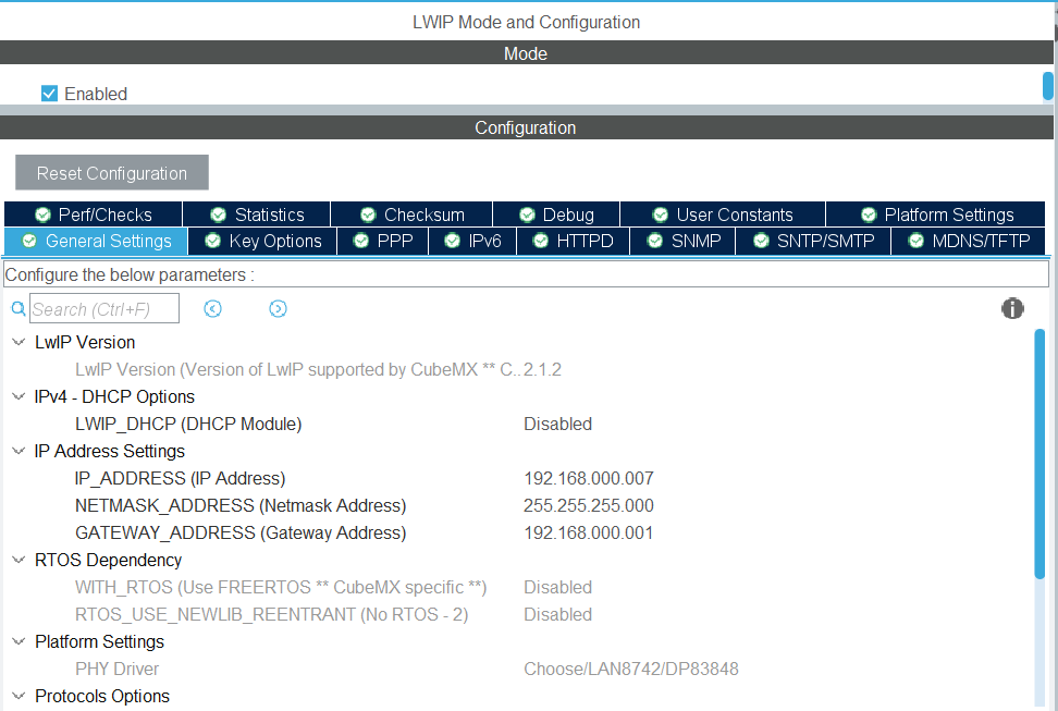

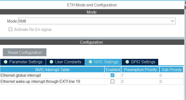

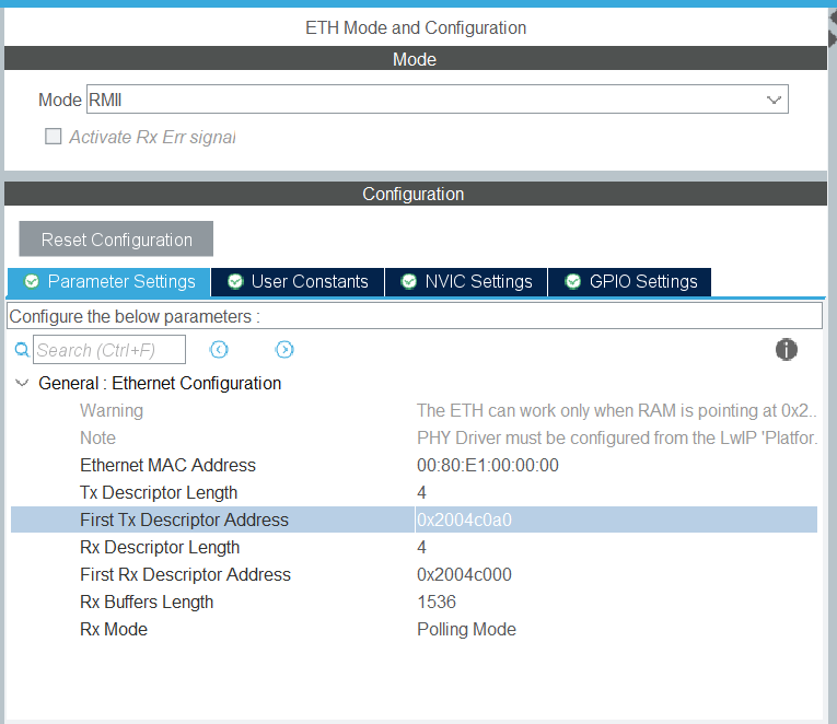

Ethernet Configuration - 1
Ethernet Configuration - 2

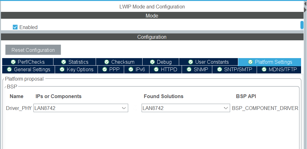

LWIP Configuration - 1
LWIP Configuration - 2
/*Memory configuration in STM32F745VGTX_FLASH.ld*/
MEMORY
RAM (xrw) : ORIGIN = 0x20000000, LENGTH = 320K
FLASH (rx) : ORIGIN = 0x8000000, LENGTH = 1024K
Memory_B1(xrw) : ORIGIN = 0x2004C000, LENGTH = 0xA0
Memory_B2(xrw) : ORIGIN = 0x2004C0A0, LENGTH = 0xA0
.RxDecripSection (NOLOAD) : { *(.RxDescripSection) } >Memory_B1
.TxDescripSection (NOLOAD) : { *(.TxDescripSection) } >Memory_B2
