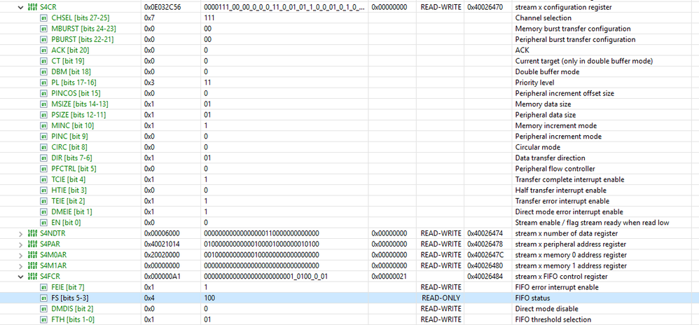

Post the content of the given DMA stream's registers.
2017-06-22 7:07 AM
2017-06-22 7:44 AM
My mistake, I found the bug...(because when I looked another time to the screenshot I posted, the DMDIS was cleared...)
I used the value 'DMA_PDATAALIGN_HALFWORD' for the MemDataAlignment parameter, instead of using 'DMA_MDATAALIGN_HALFWORD'. The HAL init was returning an error during parameter assertion, I was not checking it before. Now it works very well....
