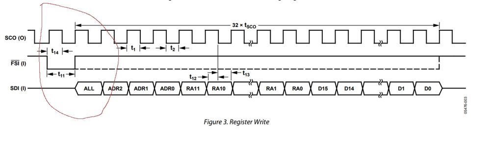

Hi. I am trying to work with AD7763. I have the same problem as in this article, but there are no answers in it. https://community.st.com/s/question/0D50X00009Xkfaw/spi-oneway-communication-slavemaster?t=1639997683527
So AD7763 is master and stm32f7 is slave. AD7763 after reset starting to generate continuous endless clock. To start the measurement I must as slave write start combination to control register, and I have 2 problems with it:
1) When I configure my stm32 as slave and send one byte with any send function (blocking, IT or DMA) it starts sending continuously, I think because of endless clock from AD7763. If I use __HAL_SPI_DISABLE(&hspi3) in HAL_SPI_TxCpltCallback, it manages to transmit 1 byte 8-10 times before stops. How can I transmit once with continuous clock?
2) AD7763 waits falling edge of write_data flag and start to read control data from stm32 on second falling clock adge. How can I do that? If I use GPIO reset function before SPI write function, time between falling edge of GPIO and spi data fronts always different and more than 1 clock of AD7763.

Thanks a lot, it seems that no problem to do so. The second question is with this diagramFSI is output for stm, and it's not NSS at all. How to connect second falling clock edge with gpio?
