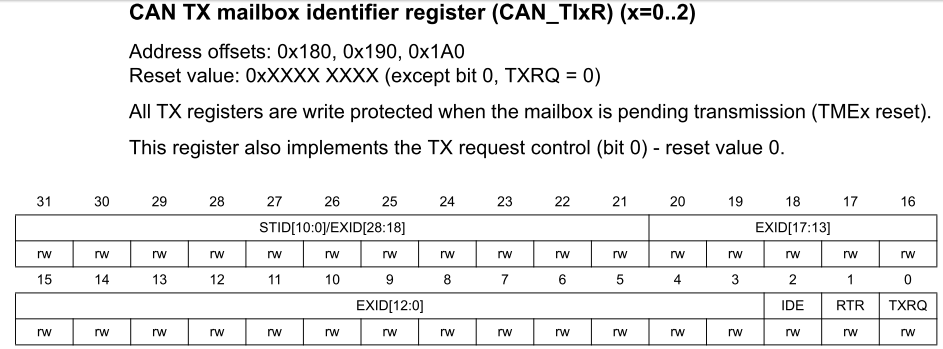

Here is picture from the STM32F103 Reference Manual .
As you can see the Std-Id is from [31:21].
If you don't shift the Filter ID the comparison will fail.
Because the STD-ID is left justified in the comparing Mailbox.

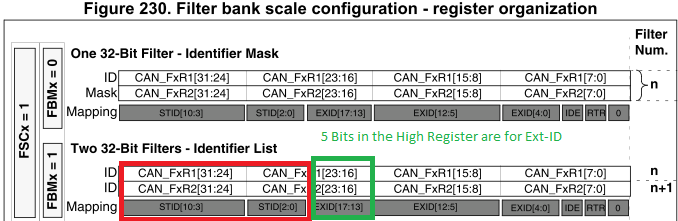

Here is a pic from the register Organisation.
Mapping is your Mailbox register.I hope this will help someone.
