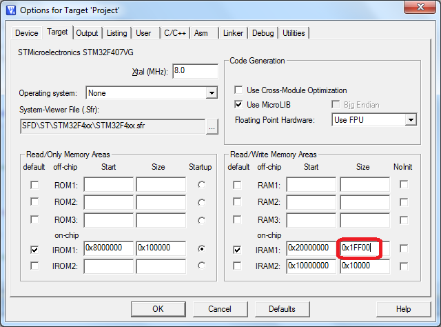

You'd want to shrink the IRAM memory allocation in the target dialog, or scatter file, so that it DOES NOT include the space you want to carve out for the parameters. This doesn't stop the memory from being useable indirectly, but does stop the linker from placing data there, and cause it to warn if the RAM requirements exceed the available space.
typedef struct _PARAMETERS { unsigned short params[128]; // Space of 256 bytes } PARAMETERS; PARAMETERS * Parameters = (PARAMETERS *)0x2001FF00; // Common Address between apps int main() { int i; for(i=0; i<10; i++) printf(''%d\n'',Parameters->params[i]); } I'd put it at the end because it's significantly less likely to be damaged inadvertently, by things like the debugger's flashing algorithm code/applet, or the user application where someone forgot to shrink the IRAM. Sorry, pulled the template from some other example2013-07-14 11:27 AM

Could you help me consider splitting my functionality into those two apps? I would like my first/boot application to configure all the peripherials (like gpios, i2c, i2s, dma) and my second application just do the calculations. Problem I noticed is executing DMA interrupts (defined in first app) what don't let me come back to DSP routines defined in second app. (commenting DMA interrupts enabling line really do the trick). I think I should divide IRAM space into two different spaces what I did like you showed in previous image (ex. 0x 1 8000 for 1st and 0x 0 8000 for 2nd minus shared buffer space so 0x 0 7F00) so both stacks won't interfere. But it didn't help. Is that the right way to do that? Or should I move all my DMA interrupts and DMA/I2S/SPI peripherials to second app so all the interrupts will be handled here and program will never come back to first app after launching?We’re moving the ST Community to a new platform to give you a better and more reliable community experience.
