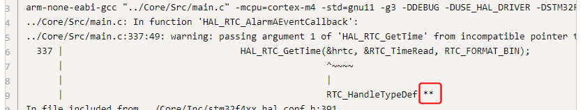

I am getting the below warning when I compile my application. However, HAL_RTC_GetTime API expects the first argument of type pointer to a RTC_HandleTypeDef structure, thats what I provide, but I get this warning as highlighted below.
15:34:16 **** Incremental Build of configuration Debug for project RTC ****
make -j8 all
arm-none-eabi-gcc "../Core/Src/main.c" -mcpu=cortex-m4 -std=gnu11 -g3 -DDEBUG -DUSE_HAL_DRIVER -DSTM32F407xx -c -I../Core/Inc -I../Drivers/STM32F4xx_HAL_Driver/Inc -I../Drivers/STM32F4xx_HAL_Driver/Inc/Legacy -I../Drivers/CMSIS/Device/ST/STM32F4xx/Include -I../Drivers/CMSIS/Include -O0 -ffunction-sections -fdata-sections -Wall -fstack-usage -fcyclomatic-complexity -MMD -MP -MF"Core/Src/main.d" -MT"Core/Src/main.o" --specs=nano.specs -mfpu=fpv4-sp-d16 -mfloat-abi=hard -mthumb -o "Core/Src/main.o"
../Core/Src/main.c: In function 'HAL_RTC_AlarmAEventCallback':
../Core/Src/main.c:337:49: warning: passing argument 1 of 'HAL_RTC_GetTime' from incompatible pointer type [-Wincompatible-pointer-types]
  337 |                                 HAL_RTC_GetTime(&hrtc, &RTC_TimeRead, RTC_FORMAT_BIN);
      |                                                 RTC_HandleTypeDef **
In file included from ../Core/Inc/stm32f4xx_hal_conf.h:391,
                 from ../Drivers/STM32F4xx_HAL_Driver/Inc/stm32f4xx_hal.h:29,
                 from ../Core/Inc/main.h:30,
                 from ../Core/Src/main.c:20:
../Drivers/STM32F4xx_HAL_Driver/Inc/stm32f4xx_hal_rtc.h:714:54: note: expected 'RTC_HandleTypeDef *' but argument is of type 'RTC_HandleTypeDef **'
  714 | HAL_StatusTypeDef HAL_RTC_GetTime(RTC_HandleTypeDef *hrtc, RTC_TimeTypeDef *sTime, uint32_t Format);
../Core/Src/main.c:338:49: warning: passing argument 1 of 'HAL_RTC_GetDate' from incompatible pointer type [-Wincompatible-pointer-types]
  338 |                                 HAL_RTC_GetDate(&hrtc, &RTC_DateRead,RTC_FORMAT_BIN);
../Drivers/STM32F4xx_HAL_Driver/Inc/stm32f4xx_hal_rtc.h:716:54: note: expected 'RTC_HandleTypeDef *' but argument is of type 'RTC_HandleTypeDef **'
  716 | HAL_StatusTypeDef HAL_RTC_GetDate(RTC_HandleTypeDef *hrtc, RTC_DateTypeDef *sDate, uint32_t Format);
arm-none-eabi-gcc -o "RTC.elf" @"objects.list"   -mcpu=cortex-m4 -T"C:\Users\bjvyhb\OneDrive - PHINIA\Desktop\MCU\Workspace\RTOS_Workspace\RTC\STM32F407VGTX_FLASH.ld" --specs=nosys.specs -Wl,-Map="RTC.map" -Wl,--gc-sections -static --specs=nano.specs -mfpu=fpv4-sp-d16 -mfloat-abi=hard -mthumb -Wl,--start-group -lc -lm -Wl,--end-group
Finished building target: RTC.elf
arm-none-eabi-size  RTC.elf
arm-none-eabi-objdump -h -S RTC.elf  > "RTC.list"
   text	   data	    bss	    dec	    hex	filename
  16684	    112	   2408	  19204	   4b04	RTC.elf
Finished building: default.size.stdout
Finished building: RTC.list
15:34:19 Build Finished. 0 errors, 2 warnings. (took 2s.589ms)
Could anyone please help me resolve ?
Thank you.

mƎALLEm
It seems a conflict between the first input argument of the callback and the definition of the global rtc handle declared in the top of your main.c:
RTC_HandleTypeDef hrtc;
void HAL_RTC_AlarmAEventCallback(RTC_HandleTypeDef *hrtc)
	printf("Alarm is triggered\n\r");
	HAL_GPIO_TogglePin(GPIOD, GPIO_PIN_14);
	RTC_TimeTypeDef RTC_TimeRead;
	RTC_DateTypeDef RTC_DateRead;
So remove & before hrtc from here:
Does it resolve your issue?

LCE
Principal II
input handle hrtc is already a pointer, so only remove the "&" for hrtc.
HAL_RTC_GetTime(hrtc, &RTC_TimeRead, RTC_FORMAT_BIN);
That is why I don't like HAL, as hrtc might be a handle, or a pointer to a handle.
In my C sources, pointers always start with "p", like phRtc, or pu32Var.
It really helps to avoid these problems.
Note that the compiler was telling you that you were providing a pointer-to-pointer (double indirection):

It's not really the fault of HAL here.
This is in user code - so the user could have (should have?) chosen to use such a naming convention; eg,
void HAL_RTC_AlarmAEventCallback( RTC_HandleTypeDef *pHrtc )
	printf( "Alarm is triggered\n\r" );
	HAL_GPIO_TogglePin( GPIOD, GPIO_PIN_14 );
	HAL_RTC_GetTime( pHrtc, &RTC_TimeRead, RTC_FORMAT_BIN );
	HAL_RTC_GetDate( pHrtc, &RTC_DateRead, RTC_FORMAT_BIN );
Using the same name for a handle and a pointer as a function call argument - I've seen that in many Cube / HAL sources.
