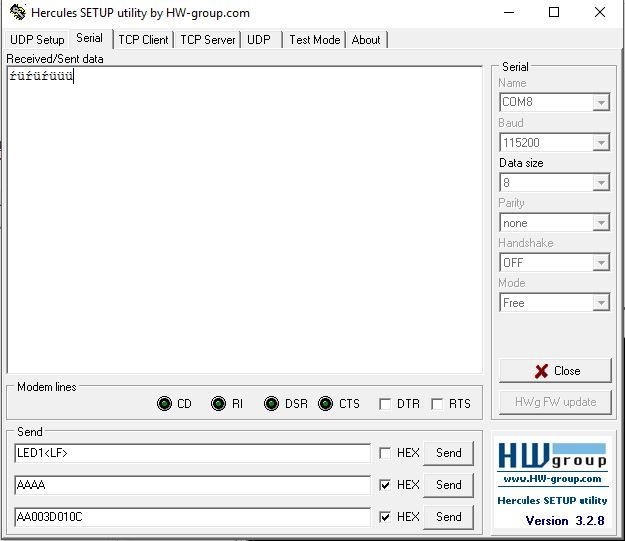

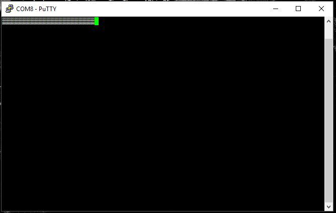

Here is my screenshots from programs (putty and hercules). In putty is more then one ''hello''. In herkules is one ''hello''.

Set the terminals to display binary/hexadecimal, as a minimum. If these two can't do it, get Bray's and/or realterm.
Any chance to get a logic analyzer or oscilloscope and observe the lines?
Btw. what's the hardware? Are there any RS232-transceiveres?
2018-01-17 6:15 AM
How have you verified the baud rate?
'garbage' like that is generally due to wrong baud rate...
