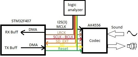

The project is just a simple sound “loop�?
It is a stm32f4discovery connected to a audio codec. They communicate over I2S3 in Full Duplex mode and the stm32f4 uses DMA to handle data.

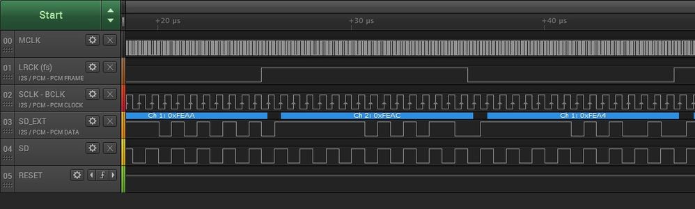

My problem is this: I’m able to send data out, but not receive any my Rx buffer is written to zero all the time.
So I can see my data is on the SD_EXT line, but I’m just not able to get it inside the stm32f4.

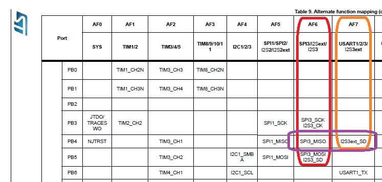

Thanks in advance #i2s #stm32 #full-duplex #dma2015-01-28 6:10 AM
Unfortunately half the defines are missing.
Double check the AF pin settings in the Data Sheet, they might not all be classified as SPI32015-01-28 7:18 AM

I'm pretty sure i checked that the pins had I2S3 as AF.
2015-01-28 8:12 AM
No, what Alternate Function is used by the pin. There's a trap for the unwary, and you've fallen in it.2015-01-29 11:29 PM
Yep, you were right, I missed that.
Now it's working like a charm.Thank you very much for your help, much appreciated.2015-06-10 2:56 AM
