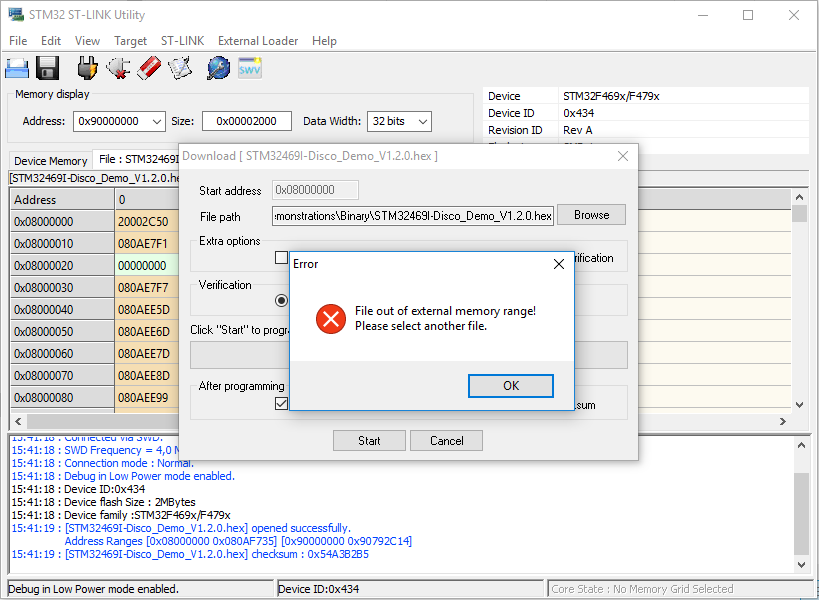

2017-09-12 9:44 AM
Hi both,
Thanks for the message. Just wondered if you could help me with this error? Thanks.
2017-09-12 10:05 AM
Hi all,
How odd - the ST-LINK doesn't like it when I program via External Loader -> .. -> Program but using the Program/Verify button on the toolbar works!
