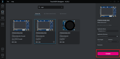

I then created a basic project under TouchGFX, in a specific folder to be able to create a CubeIDE workspace specific to that project (This is really a pain, that TouchGFX names the project with the board name instead of the project name, preventing to build several projects on the same board in the same workspace!)
I Compiled the project, loaded it onto the board fro mTouchGFX and every thing was OK.

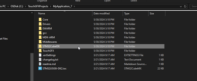

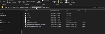

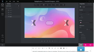

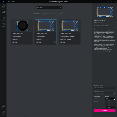

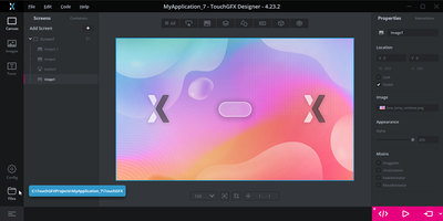

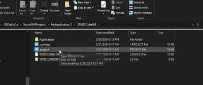

I still don't understand what you mean by importing. The way we do it here at TouchGFX is not importing but simply opening.
Create your project from TouchGFX Designer :
Create you GUI.
Generate code from Designer :
Open your projects file location :
Go back one folder :
Open the STM32CubeIDE folder :
Open your project :
No importing needed, no re-generating needed.

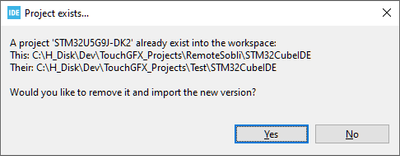

2) Doing as you suggest will anyway import the project in CubeIDE in the current workspace, leading to possible collisions (due to the identical name for all possible projects created under TouchGFX for the same kit).
This is why I open CubeIDE, select the Workspace I want, and then just import the project as a classical use of Eclipse. Otherwise I get the following message, which can be annoying...
When you do 'open' the project, Eclipse will 'import' it into the current workspace. Actually this is the wording of Eclipse.
If TouchGFX team would consider changing the way the projects are named by TouchGFX this will make our life much easier!!! ... and no questions anymore about opening or importing, or even creating a specific workspace for each application, etc...
