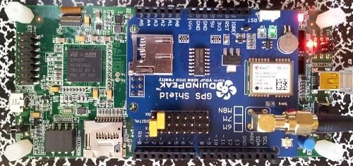

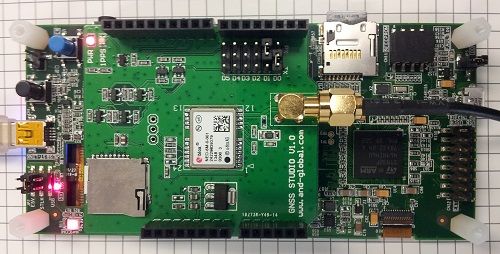

Arduino shield connector works well. D0 USART6_RX PG9, D1 USART6_TX PG14
LEDs at PG6, PD4, PD5, PK3 Here with a GPS shieldhttps://www.micron.com/~/media/documents/products/data-sheet/dram/128mb_x32_sdram.pdf
