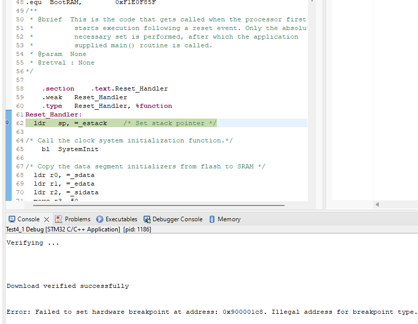

Hi Tesla DeLorean,
I am also working with the QSPI in STM32, boot from External flash (N25Q128A), And while debug, code is halting in Reset handler and not going to the main() and getting error as "illegal address for breakpoint type". and if I reset board then it is giving same error and showing "could not halt device (18)". But if I press reset button on board, It is programming the board.
2023-10-26 10:59 PM
Hi I am using STM32CubeIDE, and I am also not able to debug code (Specifically NOT HALTING CODE using breakpoint when application code executed from NOR Flash). can you please tell me the process of making symbol file and how to load the symbol into the project when I put application code in NOR flash.
