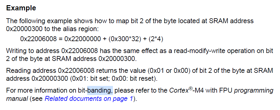

2020-08-12 6:08 AM
The reference manual gives a nice example of how to use the bit banding region:
FLASH is not bit banded. Only SRAM1 and SRAM2.
