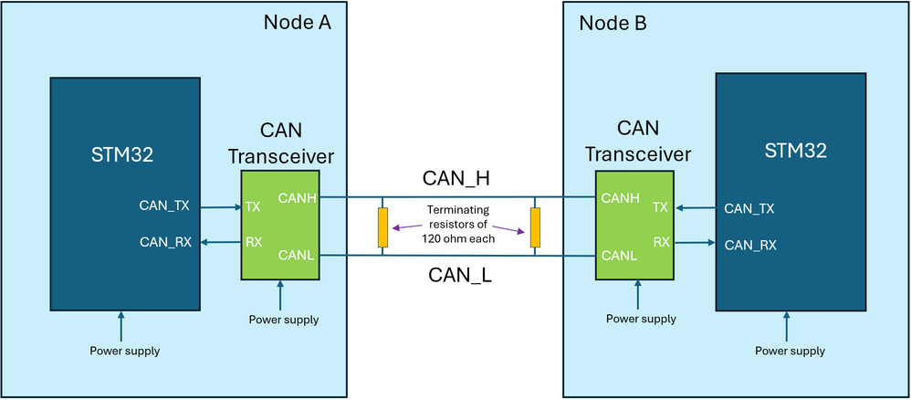

You can't do that in Normal mode. You need a transceiver for each CAN node.
And this is the (minimum) structure needed for this mode:
There are other methods without transceiver that I don't recommend.
But if you are connecting Tx to Rx (like an UART communication) this is not the correct HW for CAN and this will never work.
Hope that answers your question.
