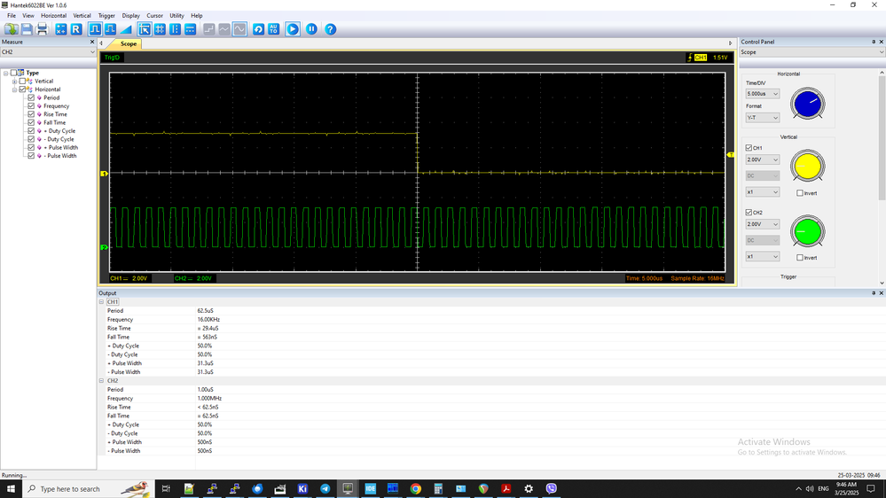

Test output pattern 0xAAAAAAAA (SD and CK lines)
Test output pattern 0xAAAAAAAA (SD and WS lines)

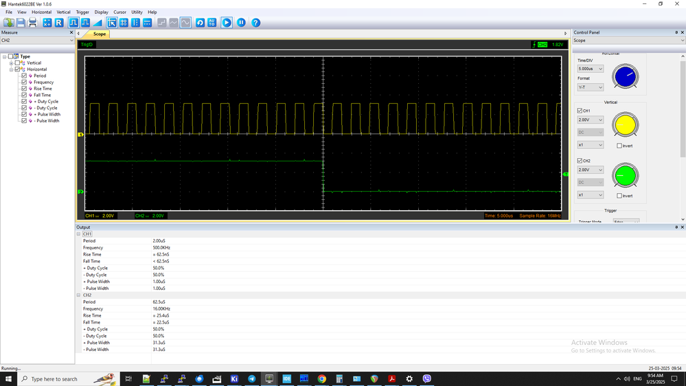

WS fall and CK:
WS rise and CK:
It looks like delayed WS latch

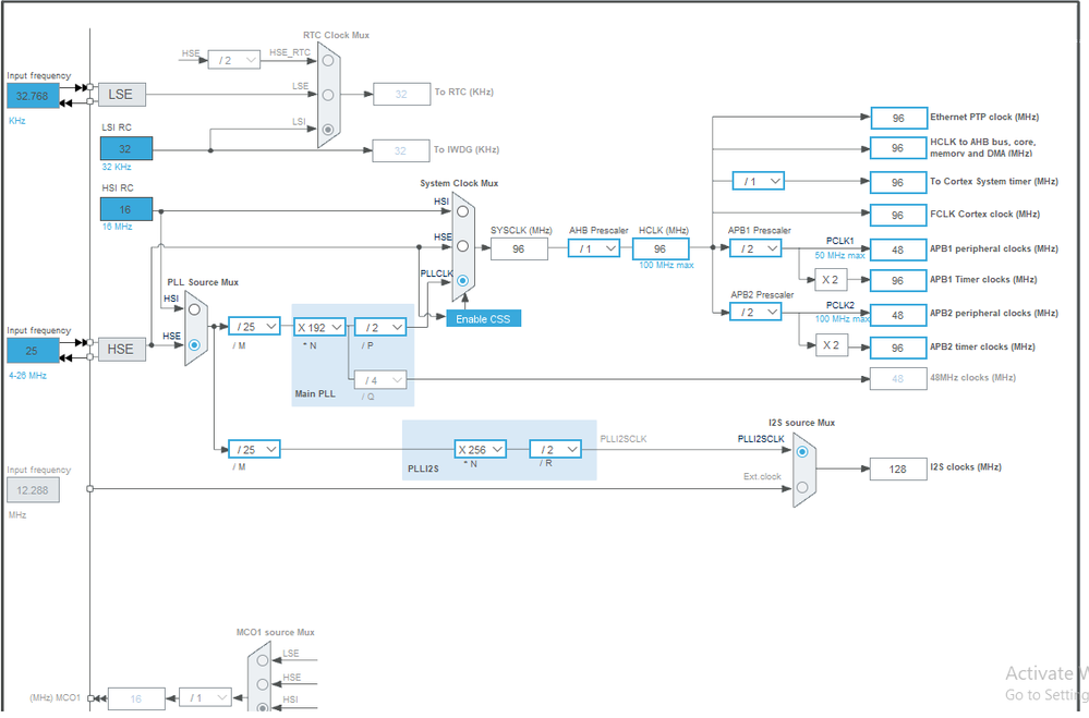

APB1 periferal clock 48MHz
APB2 periferal clock 96MHz / 48MHz
Clock configuration:

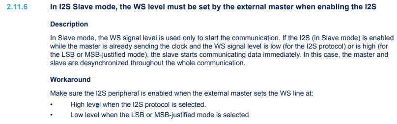

@waclawek.jan wrote:Do you observe the In I2S Slave mode, the WS level must be set by the external master when enabling the I2S erratum?
i seen that:
but i have no idea how to implement it...

Well, as the errata says, in pure slave you would wait until WS is in the inactive state and only after that you enable the I2S slave(s). Timing matters of course, so do whatever you need (e.g. disable interrupts) to avoid this to be late.
For the case where the same STM32 acts also as master in some other I2S, WS is under your full control so timing is less tight. IIRC, the master, if enabled but has no data, remains in the inactive state, but better check on this, this is not explicitly clear from documentation (and it's been quite some time I did this the last time). If it's true, then the procedure is 1. enable master I2S but don't write data to it yet; 2. enable slave I2S(s); 3. start transmitting data to master I2S (writing to its data register or enable DMA, whichever you use).
2025-03-25 2:44 PM

In step 1, I am talking about the I2S master being *enabled*, i.e. SPI_I2SCFGR.I2SE=1. I don't think this happens in your code before HAL_I2S_Transmit_DMA(). As I've said, I don't think Cube/HAL is adequate for this.
Also as I've said, I'm not quite sure this ensures WS being inactive, i.e. for I2S, high (right), you have to check this.
Alternatively, you can try simply to pull up WS somewhere in the initialization, although again, you have to ensure that subsequent Cube/HAL action won't void this in some way.
