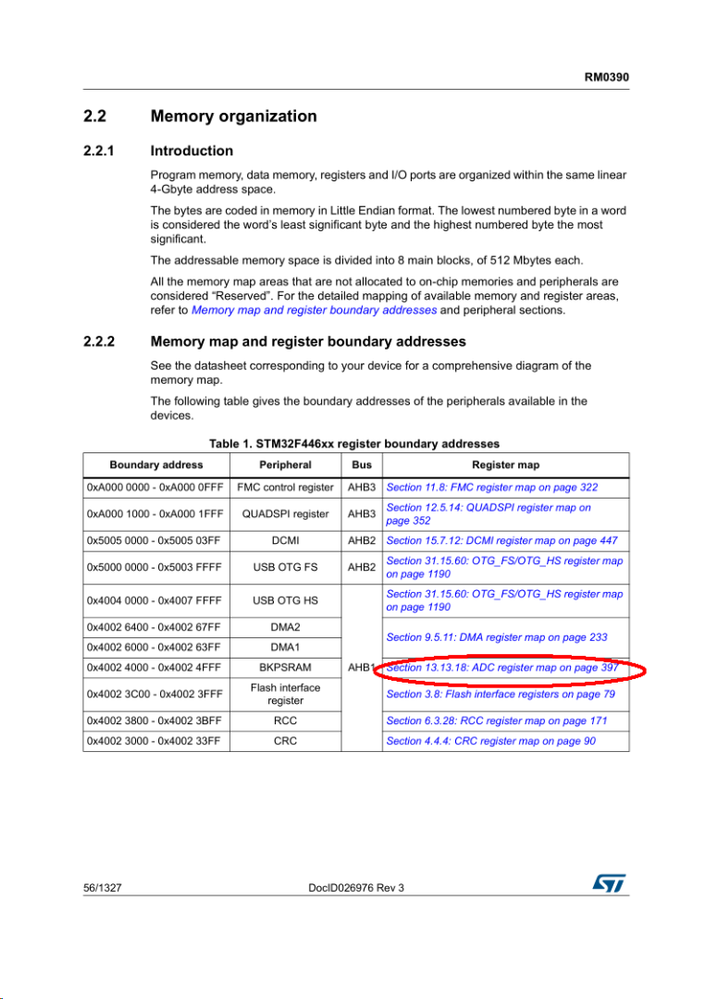

ADC is irrelevant.

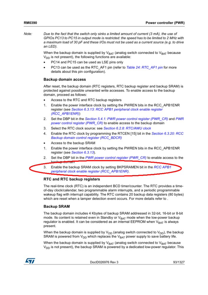

Should be RCC AHB1 peripheral clock enable register (RCC_AHB1ENR).
2017-09-12 12:16 PM

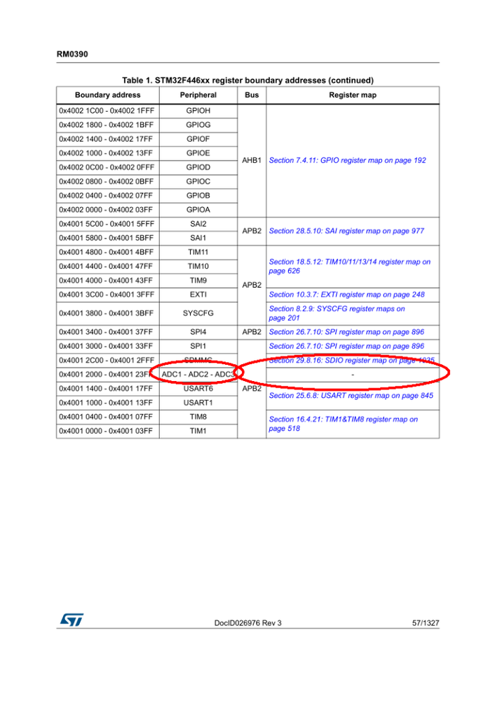

The ADC reference/link from the first picture I posted above should probably go here:
2017-09-13 4:02 AM
Hi Jan,
All the errors you highlighted are reported internally.
Thanks again!
