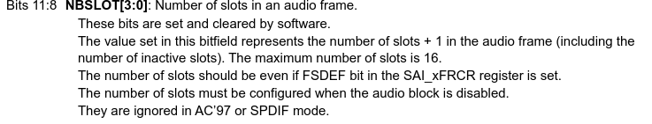

I noticed, that in the RM for the stm32f446 (v6, 2021) the description for the number of slots in the SAI peripheral (NBSLOT) seems wrong?
I am not quite sure, but the behavior on my device suggests that the bitfield represents the number of slots -1.
Therefore, I write a 0b1 for 2 slots. The way it is formulated states that it would require a 0b11 for 2 slots. Is this an error or am i wrong?

I seems to be a typo on the RM0390. I've escalated for investigation and correction on the coming releases (under internal ticket number 194461). Thank you so much for reporting.

If you set nbslot to 1 , text says: nbslot +1 -> slots in audio frame -> 2 slots .
This is also what you got - right ? (nbslot = (slots in audio frame) -1 .) same.

I think it states the value in the field = number of slots + 1. This would mean
nbslot = 1 = actualslots +1 -> actualslots = 0
