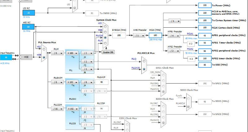

I'm working on a new board that uses the STM32F446 running at 180MHz. The board uses an external 16MHz oszillator and I would like to use ''PLLSAIP'' for the 48MHz USB clock. The clock configuration from STM32CubeMX can be seen below:

The entire file can be found . The Code runs on the target, but it doesn't get detected by USB when connected to a computer. I'm fairly sure that it is not a hardware problem, as I can communicate with the STM bootloader over USB. Also, I suspect the problem is with the clock initialization as the code is otherwise identical to code I'm using successfully with an STM32F405. Last, note that while the STM32CubeMx software can generate code to initialize the 48MHz clock on the STM32F446, I would not like to use it as it uses the HAL which I don't need for anything else.Does anyone have an idea what could be wrong with the code above?2015-09-14 11:57 AM
