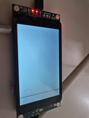

The audio playback works again, but the display shows an artifact—a black line appears on the screen (as shown in the attached image).
Have you looked at the display interface lines with a logic analyser or scope to see what's happening?
No, unfortunately I don't have a logic analyser, but I can see it on the display.
