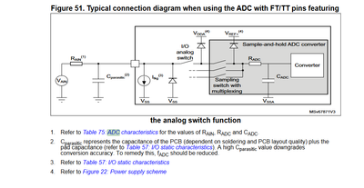

This is a very nice new figure clearly displaying what's going on (although in TT the upper protection diode on the pin to VDD is present, too, and in FT there's the patented protection scheme; but maybe those would confuse the user unnecessarily?); however, the caption is most likely not supposed to be split to above and below the figure itself:

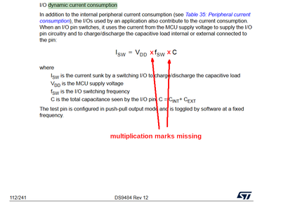

2023-12-21 4:38 AM

An internal is submitted for updating the figure 38 datasheets of F437 DS9484 rev12.Internal ticket number: 169434 (This is an internal tracking number and is not accessible or usable by customers)",
