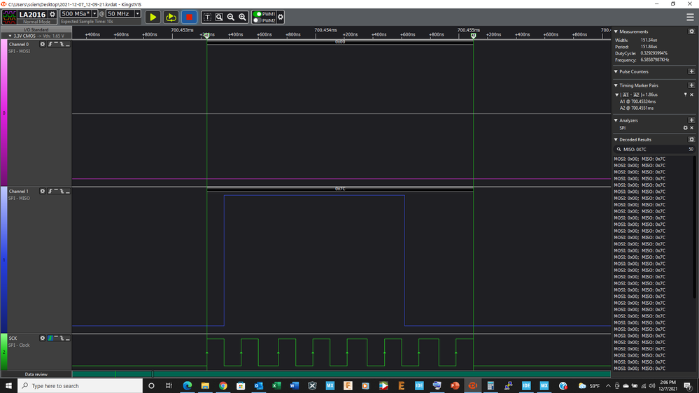

I found after reading " BRT-AN-006-FT81x-Simple-PIC-Example.pdf" it gave me an understanding of what I was doing wrong. Using someone else's code causes more trouble for me than it should.
So, to all, I thank you for your time!
