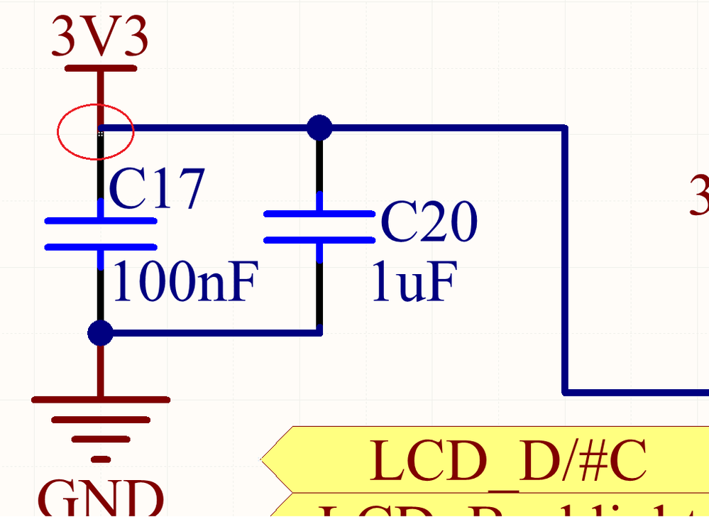

I've desingned a board for a project with a newSTM32F429VGT6 controller. My main problem is that I cannot program t
he controller, ST-Link says it ''can not connect to target''. Of course, I've already checked, the controller gets 3.3V, and the SWO pinout is also good.
I went through the datasheet again, and I I've found out, that on the Vcap1,2 pins I should measure around 1.2V. But I'm only getting some mV. I'm using 2.2uF capicators, with low ESR value. I have no idea what causes the problem, and at this point I'm pretty much stucked... :(I've attached my board pinout, maybe it helps.2015-10-06 1:50 AM
Hello guys!
First of all, thanks for all the help! I very much appreciate your time in helping me.I went through the hardware design again, checked the schematics, and I've found a quite embarrassing error, which caused all the Vcap problems and the programming errors:We’re moving the ST Community to a new platform to give you a better and more reliable community experience.
